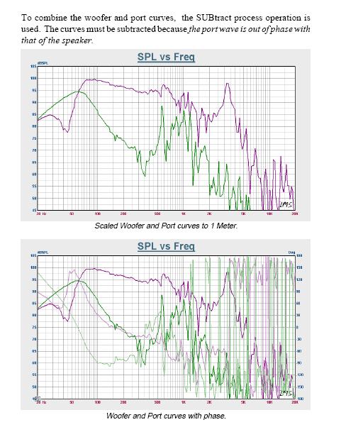

  发帖心情 Post By:2005-11-14 14:03:52 [只看该作者]
