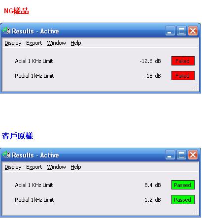

第一次接触HAC功能的受话器,还不知从何入手。
下图为一款6X15HAC功能受话器的与标准样品的测试比对值。  差异较大。
贴出来请大家帮忙看看要从哪些方面调整修改以达到和接近原样参数。(目前是采用两组32欧的线圈并联搭配)

Acoustics 发表于:2009-2-3 11:37:41
其实楼主想问的是HAC如何设计?

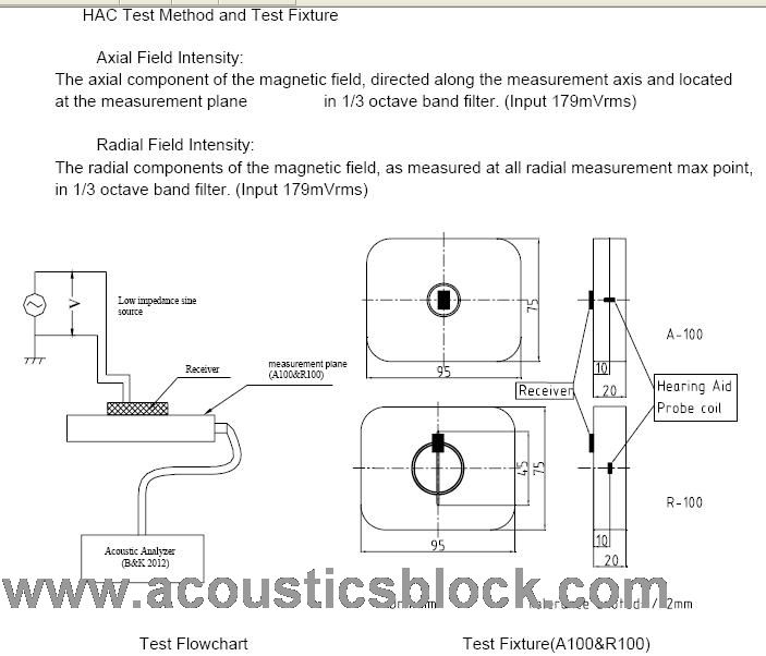

钟灵 发表于:2009-2-9 8:31:11
测试比对值?同时测试?测试仪器(包括T-COIL)与距离一样?

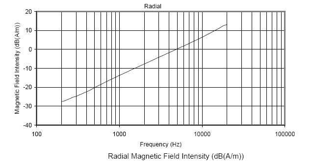

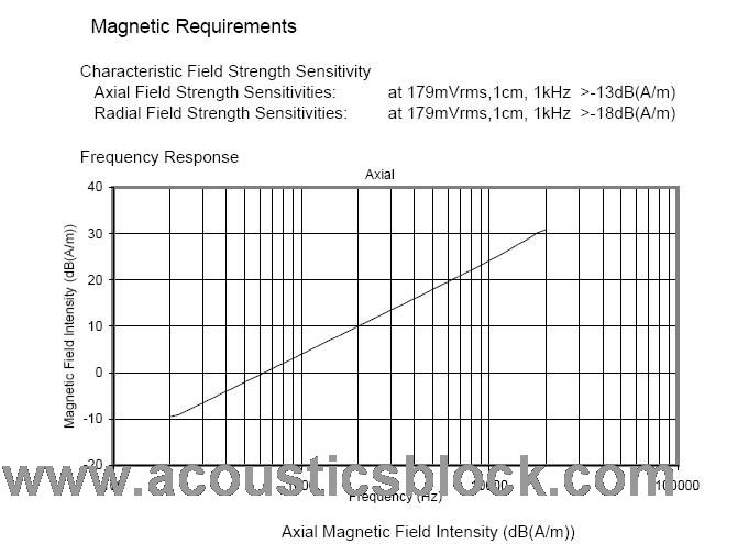

Characteristic Field Strength Sensitivity
 Axial Field Strength Sensitivities: at 179mVrms,1cm, 1kHz >-13dB(A/m)
Radial Field Strength Sensitivities: at 179mVrms,1cm, 1kHz >-18dB(A/m)
一般规格书是如此标注.这样一来楼主的样品也是符合要求的.

Hearing Aid Compatibility Probe
图片点击可在新窗口打开查看 HAC-100, $495.00 - Hearing Aid Compatibility Probe
The Hearing-Aid Compatibility Act of 1988 requires that telephone sets be compatible with hearing aids. CCL has developed a measurement probe to assist in the making of magnetic field intensity measurements as required by the FCC and Canada. The specified pick-up coil has been mounted in a probe that places the pick-up coil in the axial and radial orientations at the proper distances from the telephone set receiver. The model HAC 100 includes an Axial Test Probe(A100), a Radial Test Probe(R100), Instruction Manual and Storage Bag.

圣灵 发表于:2009-4-28 14:47:19
一般来说,hac磁场强度要求是如钟灵所贴的图示,而对于楼主的样品,2组32欧姆并联,是有人搞的,NXP的就是并联成16欧姆额定阻抗,16欧姆看起来比较奇怪,其实这也是有原因的,但是REV的承受功率就被牺牲掉了!
