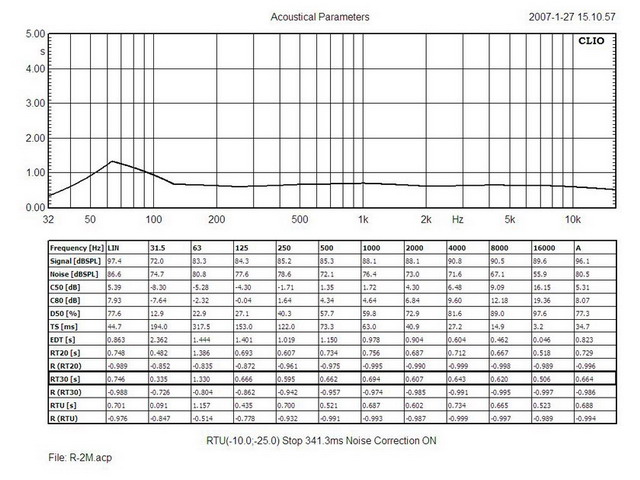

由于一般条件下难以直接获得RT60, 通常只能测到RT20和RT30. 但通常情况下最终是需要RT60作为评估参数的. 请问如何获得RT60? 特别是用CLIO系统.
xian-gen
等级:新手上路 帖子:50 积分:488 威望:0 精华:0 注册:2006-4-12 16:11:01
  发帖心情 Post By:2007-2-1 15:38:15 [只看该作者]
附CLIO测试结果示例

Historically the most important acoustical parameter is the Reverberation Time (T or RT) defined as the time, in seconds, that would be required for the sound pressure to decrease by 60dB after the sound source has ceased; this is why the most used indication you find in literature for the reverberation time is RT60. As it is normally practically difficult to obtain a sufficient dynamic range to measure the reverberation time directly, the norm provides for its evaluation based on a smaller decay of 30dB;in this case the reverberation time, indicated as RT30, should be the time evaluated considering a linear decay given by the least-square regression of the measured curve from -5dB to -35dB. Also provided is the possibility of evaluating RT20 and RTUser(based on user defined limits).

Historically the most important acoustical parameter is the Reverberation Time (T or RT) defined as the time, in seconds, that would be required for the sound pressure to decrease by 60dB after the sound source has ceased; this is why the most used indication you find in literature for the reverberation time is RT60. As it is normally practically difficult to obtain a sufficient dynamic range to measure the reverberation time directly,the norm provides for its evaluation based on a smaller decay of 30dB; in this case the reverberation time, indicated as RT30, should be the time evaluated considering a linear decay given by the least-square regression of the measured curve from -5dB to -35dB. Also provided is the possibility of evaluating RT20 and RTUser(based on user defined limits).
