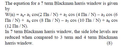

“7-term blackman-harris窗”的表达式是有。
但具体系数是多少?上述论文里也没有见到。

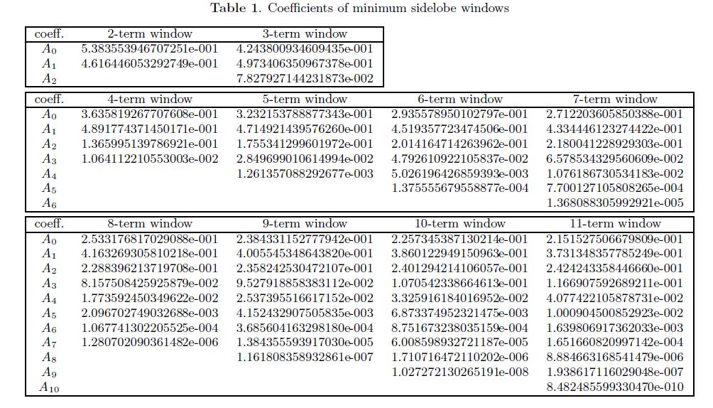

  发帖心情 Post By:2010-10-25 12:46:56 [只看该作者]
A better terminology might be "minimum sidelobe cosine-sum" window.
harris doesn't seem to have published past 4 terms and his 4 term
optimized window had 92 dB sidelobe rejection. Nuttall provided a
correction to the 4 term coefficients to yield 98 dB sidelobe
rejection. So, harris' 4 term wasn't minimum sidelobe. Nuttall doesn't
seem to have published past 4 terms either.
So, if you want a five-term minimum sidelobe cosine-sum window you
could use:
acoef = [0.3232153788877343 0.4714921439576260
0.1755341299601972 ...
2.849699010614994e-2 1.261357088292677e-3];
from the Albrecht paper:
A family of cosine-sum windows for high-resolution measurements
Albrecht, H.H.
Acoustics, Speech, and Signal Processing, 2001. Proceedings. (ICASSP
apos;01). 2001 IEEE International Conference on
Volume 5, Issue , 2001 Page(s):3081 - 3084 vol.5
The paper gives up to 11 terms and -289 dB sidelobe rejection. At 12
terms there were numerical problems with running the optimization in
64 bit floating point. Albrecht's 4 term coefficients agree with
Nuttal's 4 term values.
The 7 term window appears in some 24-bit A-D converter application
notes published before Albrecht's paper. The values published were
consistent with Albrecht's. A number of people have successfully run
the optimization for various numbers of coefficients so I go with
"minimum sidelobe cosine-sum" window for the family.

  发帖心情 Post By:2010-10-25 13:04:26 [只看该作者]
coeff. 4-term window 5-term window 6-term window 7-term window
A0 3.635819267707608e-001 3.232153788877343e-001 2.935578950102797e-001 2.712203605850388e-001
A1 4.891774371450171e-001 4.714921439576260e-001 4.519357723474506e-001 4.334446123274422e-001
A2 1.365995139786921e-001 1.755341299601972e-001 2.014164714263962e-001 2.180041228929303e-001
A3 1.064112210553003e-002 2.849699010614994e-002 4.792610922105837e-002 6.578534329560609e-002
A4 1.261357088292677e-003 5.026196426859393e-003 1.076186730534183e-002
A5 1.375555679558877e-004 7.700127105808265e-004
A6 1.368088305992921e-005
钟灵
  发帖心情 Post By:2010-10-25 13:07:12 [只看该作者]
钟灵
  发帖心情 Post By:2010-10-25 13:09:54 [只看该作者]
coeff. 7-term window
A0 2.712203605850388e-001
A1 4.334446123274422e-001
A2 2.180041228929303e-001
A3 6.578534329560609e-002
A4 1.076186730534183e-002
A5 7.700127105808265e-004
