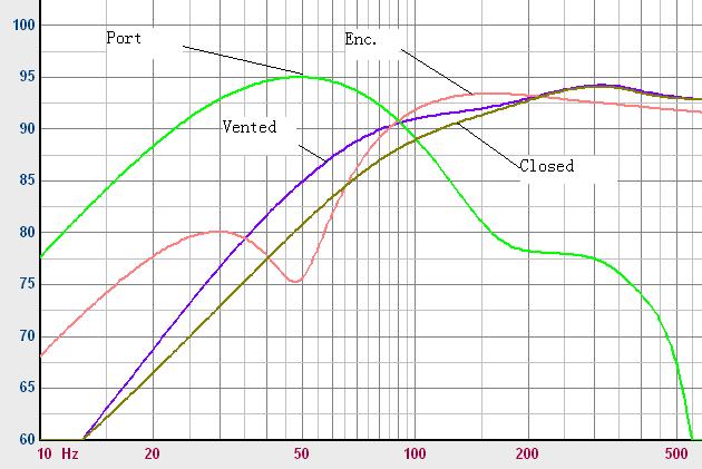

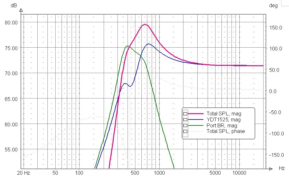

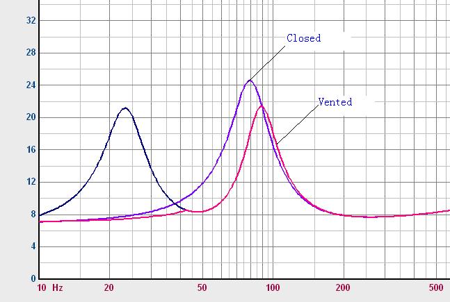

  发帖心情 Post By:2011-3-11 9:38:24 [只看该作者]
  发帖心情 Post By:2011-3-11 9:40:13 [只看该作者]
  发帖心情 Post By:2011-3-11 9:43:22 [只看该作者]
