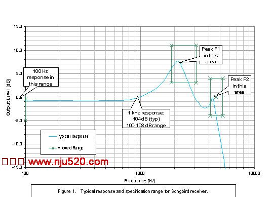

象这种用在BTE助听器的受话器,除了楼氏之外,还有谁家在做?
或者能给个内部结构分析。。。
DC resistance: 236 ± 24 ohms
AC impedance: 400 ± 80 ohms at 1.0 KHz
Isolation: 10 Megohms minimum (terminals to case)
Polarity: Positive voltage results in positive pressure
Sensitivity: 104 ± 4 dBSPL at 1.0 KHz
Distortion: 10% max over 50 Hz to 6.5 kHz
Standard test setup: A voltage source of 0.707 Vrms connected to the receiver coil through a 240 ohm resistor, the sound outlet coupled through a 10 mm x f1 mm tube terminated in an acoustical volume of 2 cm3.
Figure 1.  Typical response and specification range for Songbird receiver.
bugcainiao
加好友 发短信 工程师
  发帖心情 Post By:2009-4-29 16:44:34 [只看该作者]
给个曲线。。。

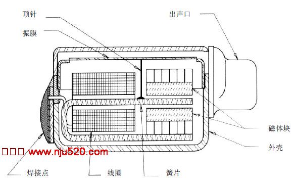

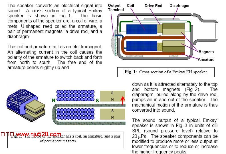

bugcainiao
加好友 发短信 工程师
  发帖心情 Post By:2009-4-30 11:25:20 [只看该作者]

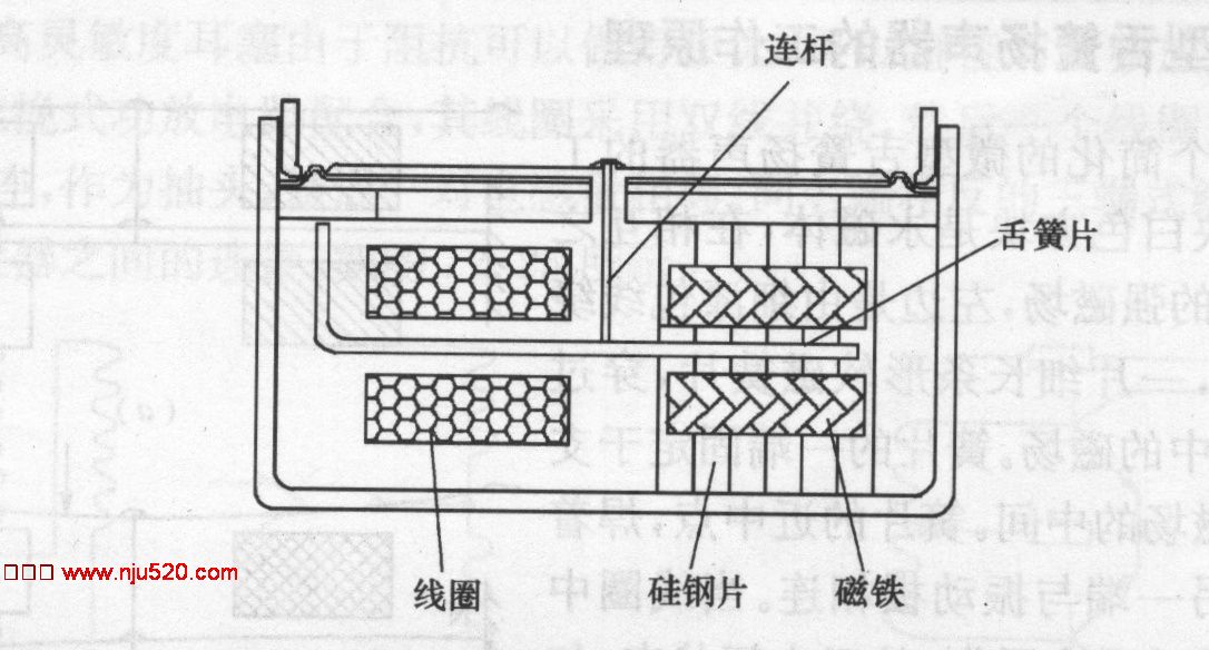

内部结构找到了,出自http://www.siemens-hearing.com.cn/support/pdf/3.pdf
  发帖心情 Post By:2009-4-30 17:22:31 [只看该作者]
  发帖心情 Post By:2009-4-30 17:23:42 [只看该作者]

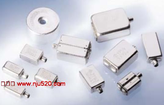

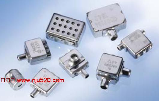

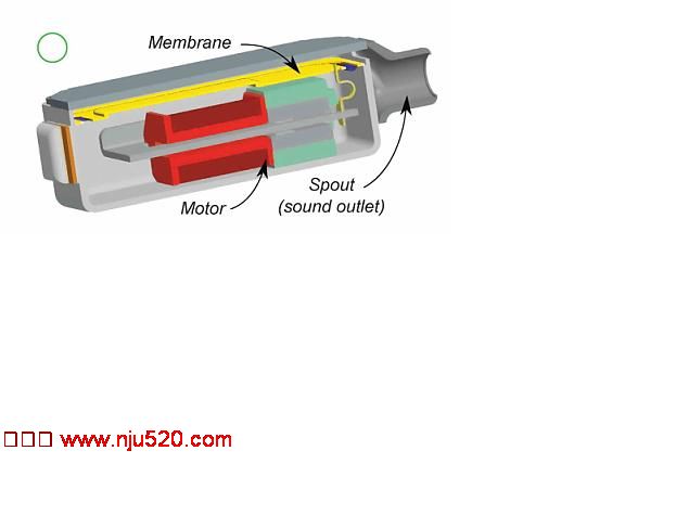

  发帖心情 Post By:2009-4-30 21:43:53 [只看该作者]
  发帖心情 Post By:2009-4-30 21:44:41 [只看该作者]
  发帖心情 Post By:2009-4-30 21:48:56 [只看该作者]
  发帖心情 Post By:2009-4-30 21:51:51 [只看该作者]

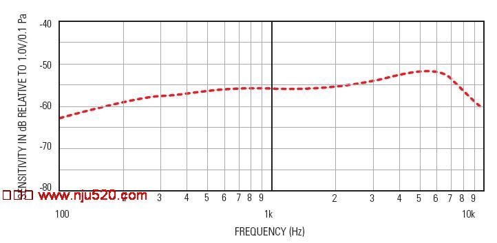

再看看MIC:
  发帖心情 Post By:2009-4-30 21:54:16 [只看该作者]
MIC的测试曲线;

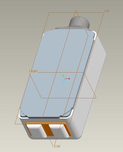

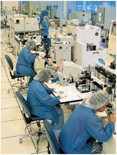

  发帖心情 Post By:2009-5-4 15:07:56 [只看该作者]
Eagle
加好友 发短信 吃素的鹰
  发帖心情 Post By:2009-5-4 16:11:30 [只看该作者]
SONION, STAR都有做这里东东。A版给出的是3维图,你们公司上马了?

  发帖心情 Post By:2009-5-4 16:23:56 [只看该作者]
觉得流水线不错,很靓!
