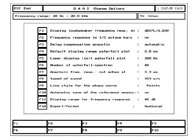

多谢!但在DAAS3L是CALSOD格式,不知是不是本公司的仪器有问体。还是在DAAS3L中设置不对。那要在主菜单F10中怎样设置,测完曲线后是F3-F5-OK后F4保存对吗?

  发帖心情 Post By:2007-12-1 10:02:38 [只看该作者]
DOS版截图不便.
先在主界面里按F10设置,再按F3设置输出格式(Export format)为Calsod(LEAP)
测试完成后,直接按F5输出(不是按F4保存,F4保存的格式还是DAAS的格式)
  发帖心情 Post By:2007-12-1 10:08:16 [只看该作者]
这是另一个版本的,在F12里选择输出格式.
Data format for export frequency response curves and impedance curves. Four formats
are available:
1. AudioCad: Frequency curves have the extension ".AMP",
Frequency phase curves have the extension ".PHA",
Impedance curves have the extension ".IMP",
Impedance phase curves have the extension ".PHE".
2. CALSOD: Frequency curves have the extension ".SPL",
Impedance curves have the extension ".IMP".
  发帖心情 Post By:2007-12-1 10:08:51 [只看该作者]
3. AkAbakâ: Frequency curves have the extension “.AKD“,
Impedance curves have the extension “.IMP“.
4. Database: hifisound database has the extensions “.DBF“ and “.FRQ“.

问题是不保存怎样导入LEAP中。F5输出到那里,怎么找不到。
新绿
  发帖心情 Post By:2007-12-5 22:12:28 [只看该作者]
路径可以自己设,默认的是DAAS安装目录下.
